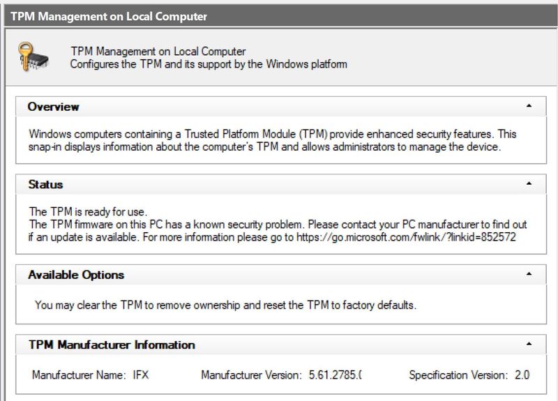

So I need an updated TPM firmware to fix the ROCA vulnerability before I can install the virtual digital badge.
I downloaded the firmware from
https://support.hp.com/us-en/document/c05792935
https://ftp.hp.com/pub/softpaq/sp84001-84500/sp84203.exe
which suppose to upgrade my firmware to 5.62.3126.0
However, the software said that it's not compatible with my laptop. Upon checking my BIOS firmware, it's F.17A which seems to be newer than the BIOS firmware that comes with SP84203.
I did a query of my current TPM version (run TPM.msc), and the version displayed is 5.61.2785 which is older than the version of the TPM fix.
So I'm now stuck, how do I upgrade my TPM from 5.61.2785 to 5.62.3126 ?
Finally found the fix to my problem, and its not coming from HP site!
http://forum.notebookreview.com/threads/tpm-security-update.813300/
Just follow the steps, and run TPM3.bat to upgrade my TPM firmware.
