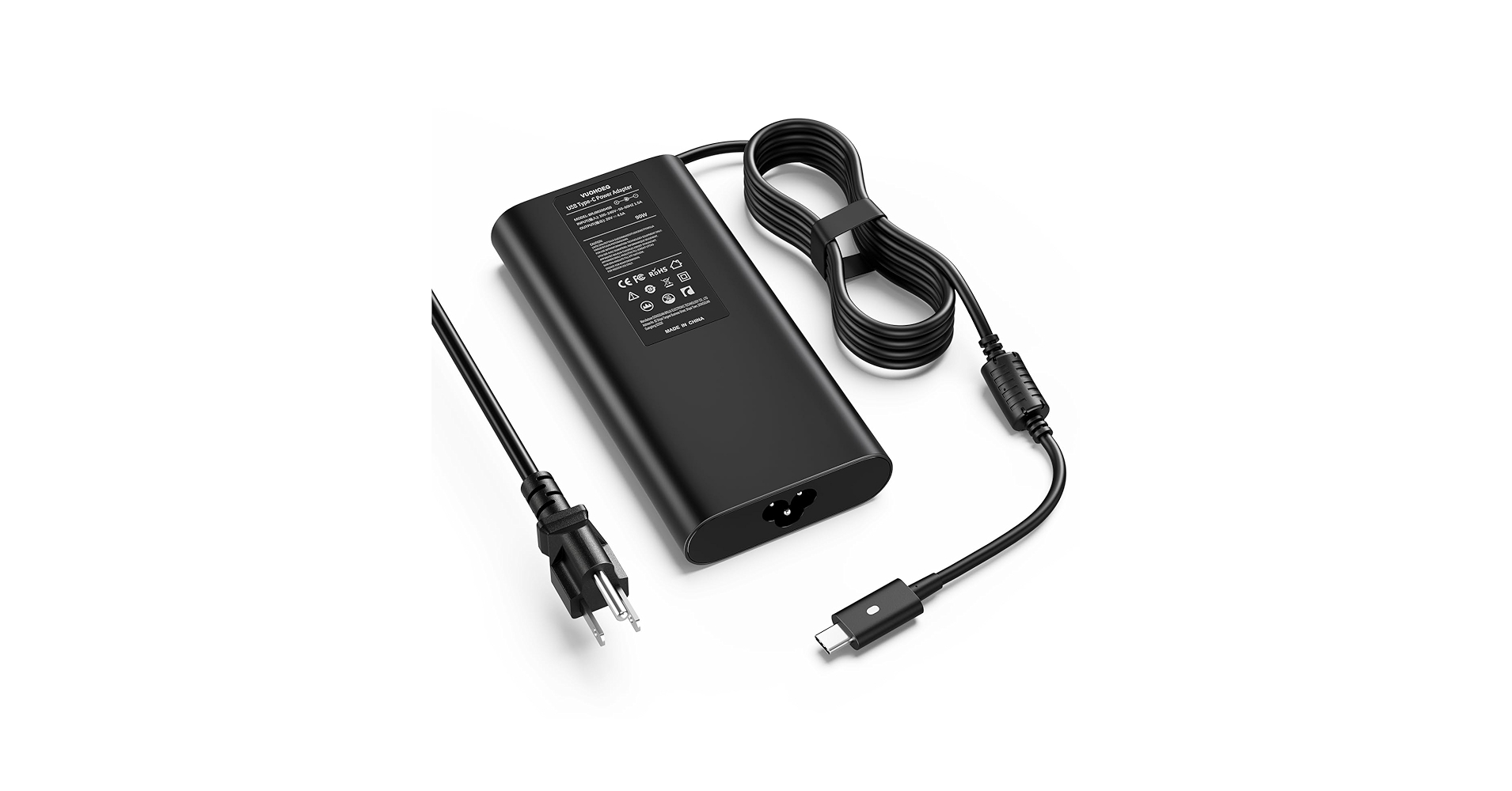

Your HP EliteBook 840 14 Inch G9 Notebook PC (4B855AV) is powered with a 65-watt power supply, with HP p/n: L67440-001 "nPFC, USB-C 1.8", or HP p/n: L04650-850 "nPFC SLIM USB-C STRT 1.8m" -please verify.
You could try a higher wattage USB-C power adapter (90 watt), such as illustrated here: https://www.amazon.com/Adapter-Laptops-Charger-Latitude7420-Latitude/dp/B076H81HP1/ref=sr_1_110?crid..., and see if this will resolve your lack of (charging) power issue.
