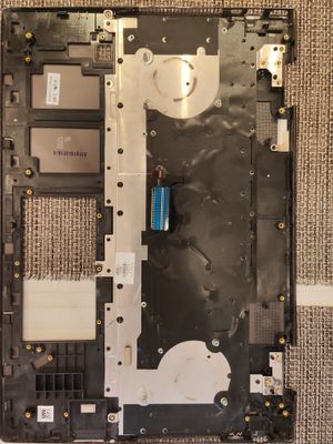

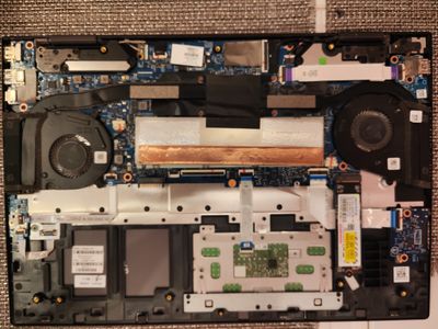

The keyboard started to malfunction - the keys "8", "i", "k", ".", which are located on the same diagonal line of the keyboard, are not pressed.
It manifests itself like this: it works without failures for several days, then it does not press in 30% of cases during the day. The problem appeared somewhere in October 2024.
I exclude the possibility of all 4 keys being clogged at the same time. I completely disassembled one of them, cleaned it perfectly - no result.
A couple of years ago there was a problem with the keyboard (keystrokes were duplicated), which was solved by updating the BIOS from F.18 to F.29 Rev.A.
On 07/12/2024, the BIOS was updated from F.29 Rev.A to F30 (the update came through the Windows Update Center). I tried to roll back to the previous version - no result.
Over the past six months, I have updated many drivers in an attempt to fix the BSOD error that sometimes appears. I assumed that this might be the problem, but there is no way to restore previous driver versions.
I found the same problem on HP Community, but there is no solution.
HP Envy 15-ds0003ur x360.
Has anyone encountered this problem?
How to find out the part number?
The problem could only be solved by completely replacing the keyboard (along with the topcase).
