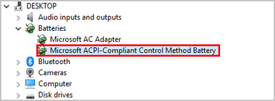

(1) Open the windows device manager and uninstall the "Microsoft ACPI-Compliant Control Method Battery
- Right click on "Microsoft ACPI-Compliant Control Method Battery"
- Click "Uninstall device"
- Confirm your choice if you see a popup notification
