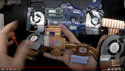

I know that on the metal-heatsink is used thermal paste. There are also memory chips on gpu, nvme drive etc..
They are covered with thermal pads. I want to know dimensions of these pads...
All I can say is look at p. 58. There is no kind of cooling device on the NVME M.2 SSD for sure. If there are pads, they are on the heatsink and HP does not publish the diagram of how the heatsink is made. If you want new thermal pads (I still think there aren't any) you just need to get a new heatsink. You do not give us the full model number (2 letters after the numbers) so I am not even sure what heatsink you have to try to find a picture of that part.

Actually I found video: https://youtu.be/zhJj9Dcym8Q?t=659
As you can see there are some pads....
Screen from the video....

That's a different kind of thermal pad than I thought you were talking about. Some laptops use something made from like heavy wool with a metal foil insert and those you cannot remove or replace. That is 3 mm thermal padding that comes in sheets or rolls like this:
https://www.ebay.com/itm/100x-100-3-0mm-3mm-Silicone-Thermal-Pad-Sheet-Computer-Chip-Heat-Sink-HeatS...
Thank you, thats what I have been looking for.
