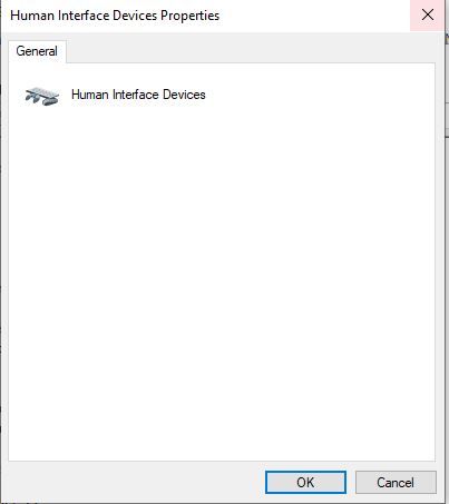

I tried to do the troubleshoot in the devices and drivers.  I had to google how to do it and it appears that when I go to properties, I do not have the tab that says 'driver'.  I don't know if I missed something or if this is a sign of part of the problem.

@SCAREDYCAT83
This might require remote access of your computer to fix the issue.
I request you to talk to HP support.
They might have multiple options to help you with this.
