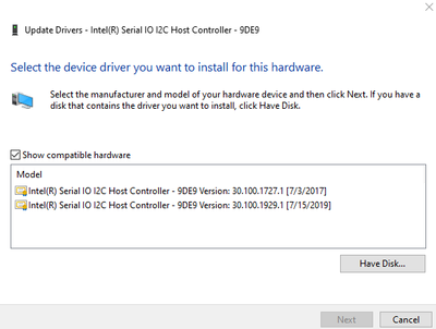

So... Device Manager-->Intel(R) Serial IO I2C Host Controller - 9DE9 properties-->Driver tab--> Update Driver button.
My first impulse was to try the one I FTP'ed, so first, I chose "Browse my computer for drivers--Locate and install a driver manually." I'd tried clicking into the swsetup\SP92020 folder, opened the "base" folder and seen it contained a .sys file with the same name as the driver I'd deleted, so I figured, okay, search for drivers in this location: C:\swsetup\SP92020, and include subfolders. HOWEVER, that gave me the message "The best drivers for your device are already installed," and I was like, "WHAT!? THERE AREN'T EVEN ANY DRIVERS INSTALLED FOR THIS DEVICE RIGHT NOW!!!"
The next suggested step, checking Windows Update, had been failing me all this time, so instead, I clicked the back button, clicked "Browse my computer for drivers--Locate and install a driver manually" again, and this time, I clicked "Let me pick from a list of available drivers on my computer"...
..and finally, I started getting somewhere--it offered me two drivers:
At this point, in the thick of things, I couldn't tell which of those two was the one I'd FTP'ed (answer: the 7/3/2017 one), or where the other one had come from (still not sure), but I figured, okay, let's try one, and if it doesn't work, uninstall/delete/try the other one, and I chose the newer version, 30.100.1929.1 [7/15/2019] and clicked Next.
...and in an instant, my device manager went from this to this:
And I unplugged my mouse, and my touchpad was working, and I was so happy I could die.
