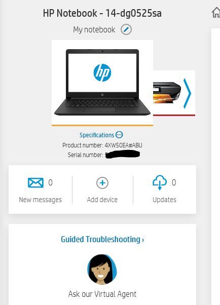

Hi KrazyToad 🙂 Thanks for your reply.
I have already done what you have suggested and so my laptop is totally up to date with all the latest drivers from both HP
Support Assistant (I have Version: 9.7.433.0 installed) and from Windows Updates.
I have performed update checks again just now but there are no new updates to install.
Unfortunately I still have the same issue with touchpad not working.
Any other ideas please?
