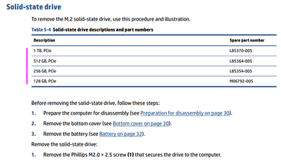

HP service manual:
http://h10032.www1.hp.com/ctg/Manual/c07012038.pdf
From page 35 ...

The service manual indicates that both SATA and NVMe SSD's are supported.
Hopefully you will be able to get the NVMe drive to work.
