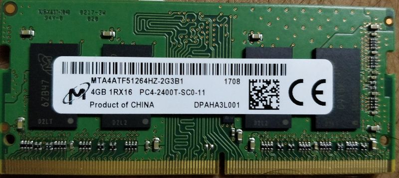

Just to avoid confusion, I open the laptop and took snap of the RAM that is in my laptop currently, can you have a look at it and tell me exactly what spec I should buy, please.
Sincerely appreciate your support....
That is DDR4-2400 but the chip configuration is different than the Crucial you asked about. Where do you live (country)?
