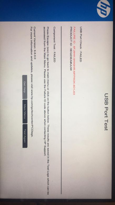

Thanks for answering, that makes it clear ..
I have got this ..
52854523_10157033356926550_3976841104199778304_o.jpg52854523_10157033356926550_3976841104199778304_o.jpg
You have a legitimate basis for a warranty claim but that cannot be done through the Community. Where did you buy the laptop? You may have a return privilege if you bought it at a store or you may need to open a support case with HP.
