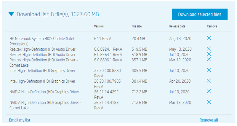

@The_Fossette, many thanks, nice simple instructions. Appreciate it. Also, was not expecting a response on a Sunday!
How are you, your colleagues and your loved ones. Hope you are not badly affected and keeping well?
As suggested, I've run the diagnostic for my laptop and it looks like a lot of drivers need to be updated, so apologies, two dumb questions before I start updating things.
Q1. These were just the BIOS (1), Driver -Audio (3) and Driver - Graphic (4) driver updates that came up. Please can you confirm I need to download all of them?
Q2. The Diagnostic tool also came up with a lot more. Should I update all of these drivers as just simply good maintenance?
Thanks and very much appreciate your help.
Nigel db
@Nigeldb
Thank you so much for checking and I am doing fine and wish the same for you.
Yes, install all the drivers and tests.
Let me know how it goes.

Hi @The_Fossette,
A bit of feedback and a question re HP Support Assistant
1. The assistant downloaded the updates but did not automatically install them. It stated there would be a slight delay and that installs would be in a separate window but nothing happened for 10 mins so I ma restarting and installing each one manually. Wish me luck.
2. Why did the support assistant say everything was up to date (see image) but the site you sent me to https://support.hp.com/in-en/drivers said I needed to install multiple drivers.  One of them has to be incorrectly reporting?
Hi @The_Fossette, apologies but now I'm really confused.
1. I ran the Install wizard which downloaded but didn't install (see previous message)
2. I manually installed the drivers but at least three of the recommended drivers came back with an error message "Driver not supported" (see image below)
3. I reran the driver check under the site you gave me and it lists exactly the same drivers updates as being required so has nothing been installed? I know the whole BOIS update was installed as the laptop went through the BIOS update warning screens and restarted.
4. When I go to HP Support Assistant, it still says all drivers are up to date, even when I do a refresh on "Software and Drivers". It says everyhthing is fine. and up to date
Apologies @The_Fossett, I now have no idea whether the drivers are up to date? Hoping you can help.
@Nigeldb
This only means this particular driver package is not supported on your Windows 10 Version
HP Support Assistant will automatically update all drivers that are compatible and will leave out the non compatible drivers ( Drivers that are for other Windows 10 Version )
KrazyToad
I Am An HP Employee
