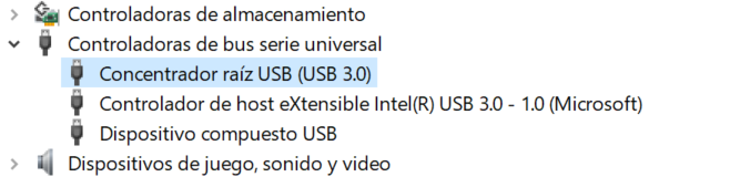

Since a couple of months ago the USB ports on the right hand side of my laptop are not working, they don't recognize any device and I have tried the below without any success:
1) Device Manager > Universal Serial Bus > USB Root Hub option > Properties > Power Management tab and uncheck the Allow the computer to turn off this device to save power option > OK > save > restart
2) Panel control > Power Options > change plan configuration > change advance configuration > USB configuration > I unabled the selective suspend setting > save > restart
3) Panel Control > Choose what the power button does > change settings that are currently unavailable > uncheck the Turn on fast startup > save > restart
4) Device Manager > Universal Serial Bus > for each option check if there are updates available > all updated
The power port and the USB port on the left hand side do work and recognize, however sometimes the USB port stops recognizing devices in the process.
Can you please advice?
Thanks!
Extra attachments:
1. USB details in device manager view (sorry I have my configuration in spanish)
2. Ports on the right hand side

  8. Uninstalling USB Root Hubs: Uninstalling USB Root Hubs forces the system to reinstall the root hubs next time the computer is started. Use the following steps to uninstall USB Root Hubs:
    1. Disconnect all USB devices connected to the computer except a USB mouse and keyboard (if in use). This includes hubs, thumb drives, printers, and cameras.
    2. In Windows, search for and open Device Manager.
      The Device Manager window opens.
    3. Double-click Universal Serial Bus Controllers to expand the list.
      Figure : Universal Serial Bus controllers list in Device Manager window
    4. Right-click the first USB Root Hub in the list, then select Uninstall.
      Figure : Uninstall selection in the Device Manager window
      Click OK to confirm.
    5. Continue uninstalling all USB Root Hubs listed.
    6. Close Device Manager and restart the computer.
    7. If the USB device that is having problems came with software and it was not previously installed, install the software now, following the manufacturer instructions.
    8. Reconnect the USB device that was having problems and test it to see if it works.
