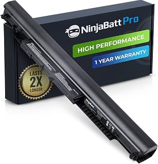

What I would do is get a new battery, if the ac only power connection is failing sometimes, the battery will keep the PC from turning off. The part number for the battery is 807956-001
https://www.amazon.com/s?k=807956-001&i=electronics&ref=nb_sb_noss_2
