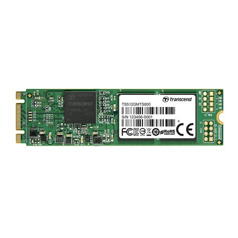

Its an M.2 slot but not NVME....will only support a SATA type M.2 disk. 2280 form factor like the Samsung Evo 860 or similar.
Even though the slot has 2 chambers, M.2 disks with three prongs (B + M keyed) will fit in the slot.
This is the kind of M.2 you needThis is the kind of M.2 you need
