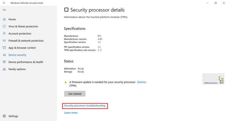

I have the same problem with my machine since upgrding to to v1803.
I get notification in Windows defender for a security problem.
updated my BIOS to the latest version - F.50 using sp86795.exe from https://support.hp.com/us-en/document/c05869091
At first I tried to clear/reset the TPM from the BIOS and it didn't work still got the same notification.
and it didn't solve the problem too...
Any suggestions ???
