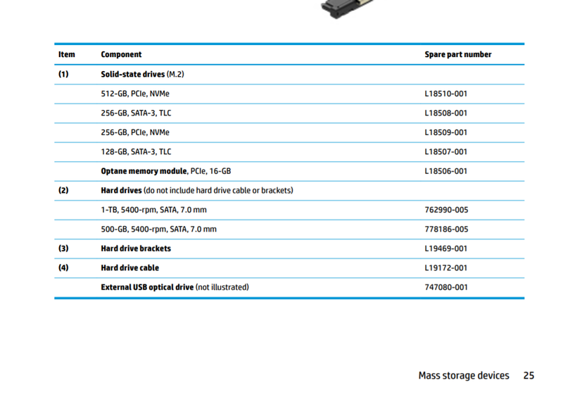

According to the Maintenance and Service Guide it does support NVMe:
https://support.hp.com/us-en/product/hp-pavilion-14-ce0000-laptop-pc/20283999/model/22410240/manuals
**Click Accept as Solution on a Reply that solves your issue**
***Click the "YES" button if you think this response was helpful.***
You mean this page, bro?
