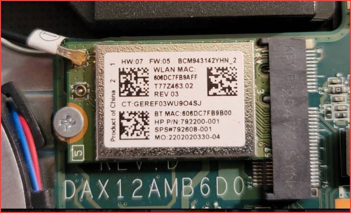

I opened up the laptop - what a nightmare!  I got in there and saved all the screws and mostly didn't break anything.  I'm trying to match up the numbers with what you said, but I'm still a bit confused.  I have attached a photo of what I have.
I never use Bluetooth with this and even if I ever had to, I could add one of the dongle things.  What I really want is RJ45 and WiFi speed.  Do you have a suggestion for the best unit to purchase?  Thanks!

You're very welcome.
Since your notebook only has one antenna wire, here's your options:
The Realtek 8821CE card has a maximum throughput of 433 MBPS on the 5.0 GHz Wi-Fi band, and the card's Wi-Fi and Bluetooth is fully functional with one antenna wire.  So, that would be the logical choice.
I checked the part number HP gave for the Intel 7265 and that was incorrect.  When I search on eBay, I get listings for the Intel 3160AC which has the equivalent specs of the RTL8821CE and the Bluetooth wouldn't work, so it makes no sense to install the 3160AC.
If you want to go 'out of the box' and experiment with a Wi-Fi 6 card, you can try this one:
Intel Wi-Fi 6 AX200 ax 2×2 + Bluetooth 5.0 MU-MIMO M.2 2230 non-vPro   HP part # L35282-005.
The Bluetooth will not work without the second antenna wire, and I can't tell you if the Wi-Fi reception will be degraded and if so by how much?  Therein lies the question.
You should be able to find the RTL8821CE model Wi-Fi adapter on eBay by searching by the HP part number as, well as the Intel AX200.
Regarding the ethernet, you can buy a USB to RJ-45 gigabit ethernet adapter, plug it into one of your notebook's USB 3 ports and you should get much better download speeds than the current Realtek 10/100 ethernet adapter is giving you.
