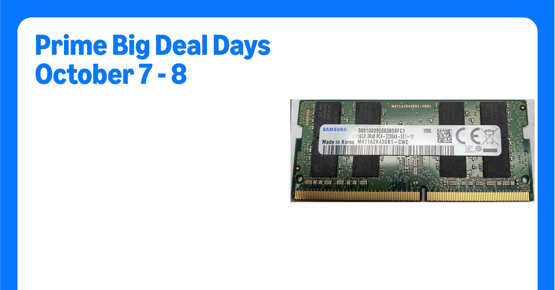

Here you go, the single 16GB Samsung RAM stick (p/n: M471A2K43DB1-CWE), can be purchased relatively inexpensive here (you need two of them, of course): https://www.amazon.com/3200MHz-PC4-25600-260-Pin-SODIMM-M471A2K43DB1-CWE/dp/B08DL8FKS8.  ("Tips" says, quote: "You found a deal! The price is currently on the lower end compared to other stores we checked.")
In the off-chance this RAM doesn't work either (that would surprise me given my previous experiences with thought-out Samsung RAM for HP computers), one of the advantages of ordering through Amazon anyway, is that you can return it and get your money back.

@lmcbrpe,
