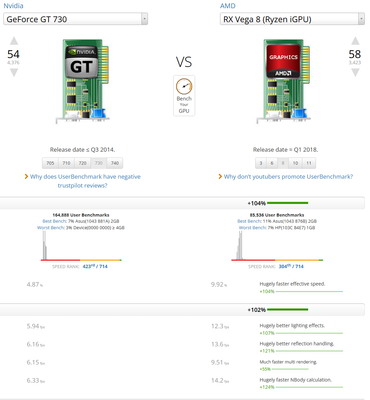

Something else, my friend.  I am not sure what the OP is trying to accomplish with a GT 730 -which is situated at the very (rock) bottom of the graphics cards listing.  As a matter of fact, the OP's processor, which, according to the aforementioned specs is a Ryzen 7 5700G, is fitted with a powerful iGPU (integrated graphics) named Radeon Vega 8, which is far more powerful than what a GT 730 has to offer:
Link: https://gpu.userbenchmark.com/Compare/Nvidia-GeForce-GT-730-vs-AMD-RX-Vega-8-Ryzen-iGPU/m12582vsm441....
