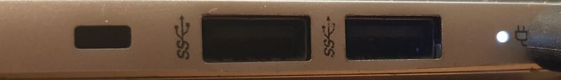

As far as multiple monitors, your USB-C ports are data only so they provide no video signal. You would have to use a DisplayLink type port replicator to use the USB ports to drive one or more monitors. Like this although lots of possible options:

1. Please clarify: Are you saying I cannot connect a display cable directly to my USB port (3.0, I think), but I can connect a docking station that will be able to transfer another external display (except the existing HDMI output) through the USB port?
If it's possible, these are great news.
I provided photos of the 3 USB ports I have.
Which port is able to connect a docking station with a display port?

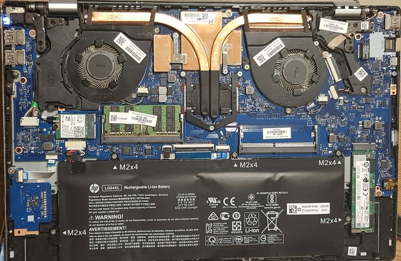

I opened my HP cover and discovered for myself...
The HP WhatsApp support told me I can open the cover without voiding the warranty, so now I know more and can share it here with you:
What I found Inside my HP pavilion 15-cs3001nj  (photos attached)
I must say I was very surprised to see a motherboard architecture different than some 15-cs3XX photos I searched on the web.
My motherboard is MB: G7EL DAG7ELMBACO REV C
I didn't find a space for a 2.5" drive.
I found two RAM slots  (and still need to know if it can take 2X16GB or even 2X32GB So-DIMM (just because it was mentioned on the Crucial website)

Huffer, relevant to your reply: Since I cannot find a 2.5" drive I think your information is inaccurate to my model (or the space is hiding in a place I cannot see, photos attached).

HP pavilion sc3001-nj model 8PL08EA#ABT under the cover.jpgHP pavilion sc3001-nj model 8PL08EA#ABT motherboard DAG7ELMBACO REVCHP pavilion sc3001-nj model 8PL08EA#ABT motherboard DAG7ELMBACO REVCHP pavilion sc3001-nj model 8PL08EA#ABT SSD INTEL M2 NVMe MODEL SSDPEKNW512G8H.jpgHP pavilion sc3001-nj model 8PL08EA#ABT RAM SAMSUNG 16GB MODEL STNAA1001937587E07HP pavilion sc3001-nj model 8PL08EA#ABT RAM SAMSUNG 16GB MODEL STNAA1001937587E07HP pavilion sc3001-nj model 8PL08EA#ABT under the batteryHP pavilion sc3001-nj model 8PL08EA#ABT under the batteryHP pavilion sc3001-nj model 8PL08EA#ABT  2 USB ports rightHP pavilion sc3001-nj model 8PL08EA#ABT 2 USB ports rightHP pavilion sc3001-nj model 8PL08EA#ABT USB-C port leftHP pavilion sc3001-nj model 8PL08EA#ABT USB-C port left

I have seen 2 port DisplayLink docks and you could have a monitor from HDMI and also the two from the dock. SLI has got nothing to do with this. That's multiple video cards on one motherboard, connected together. Not really a laptop thing. Happy to discuss further if you wish.

Maybe I misunderstood you, and I hope I didn't offend you, but I couldn't find any space for 2.5" drive.
Correct me please if I'm wrong, but I'm looking for an inner space that can fit a 2.5" size disk.
One of the photos I uploaded didn't go through, so I'm trying to put it again, and see if it helps. Can you  find it in the photo?
All the rest of the information you provided is great.
And all my other information came from official HP support after I have given them my serial number, so I thought it should be reliable. That was my mistake 🙂
Here is the photo (please tell me what area to look for the 2.5" space, or confirm that there is none):

Yes, you have one of the models with a 4-cell battery. The 4 cell occupies the space where the hard drive would go. Only models with the 3-cell battery have a 2.5 bay. Compare pages 37 and 38 of the Manual I posted. The cable and caddy are hard to find, anyway and a large capacity NVME is still the way to go.
