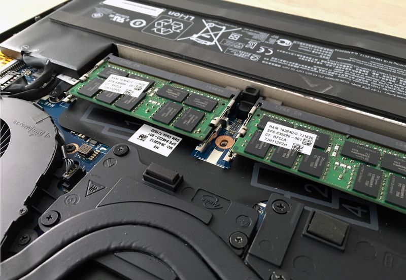

Yes, I also confirm BeemerBiker's interpretation of the manual. The numbers 1 and 2 (and then 3 and 4) are the slots that have priority when you install the RAM modules, so as to get the best performance. For slots 1 and 2, this means dual-channel performance.
This old Notebookcheck review of your model shows how HP factory-fitted the two 16GB RAM modules, and they are in slots 1 and 2.
There is also this old post (https://h30434.www3.hp.com/t5/Notebooks-Archive-Read-Only/ZBook-17-G3-Mix-memory-modules-of-differen...) by @Huffer EXPERT Level 18 where he explains that RAM modules in slots 1 and 3 work in dual-channel mode, so it's quite possible installing either way will lead to a correctly working config.
