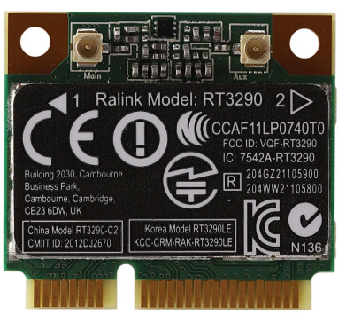

Hello. I have a laptop HP Pavilion 17-e072sr.
Currently it has wifi card Ralink RT3290 in it.
I want to replace it with a different wifi card with higher connection speed and 5G support.
Are the cards below compatible with HP Pavilion 17-e072sr?
  1. Atheros QCA9377
  2. MPE-8265AC
  3. Intel MC-AC7265
  4. Intel 7260HMW
They all look similar to Ralink RT3290, however I heard that many wifi cards are incompatible with HP / Lenovo and some other laptops due to BIOS whitelist issues.
