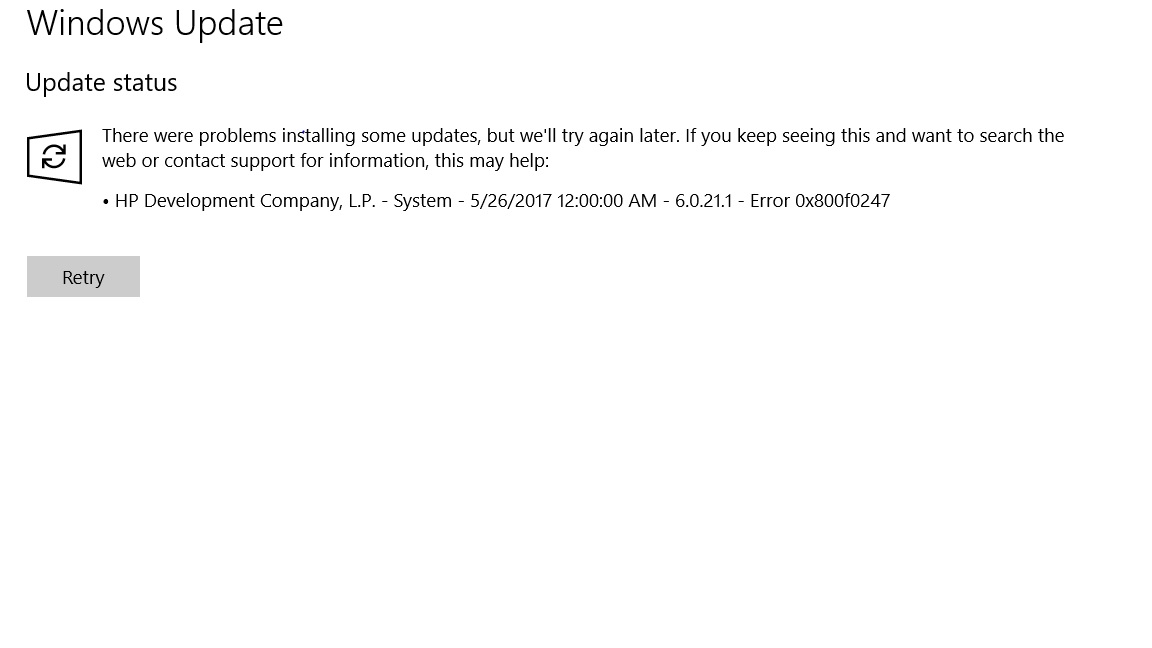

Hello.I keep gettig this error code when i try to do this windows update.• HP Development Company, L.P. - System - 5/26/2017 12:00:00 AM - 6.0.21.1 - Error 0x800f0247.
Can any one help with this update and why it is not updating.

Even I'm also facing the same issue since morning. Please look into the same and help accordingly.
Attaching the error screenshot for your reference...
I have reported the error and someone is looking into it.

Download Windows 10 Updates Troubleshooter Tool from Microsoft
Run it and click on "Hide updates" option and you'll be able to hide desired update  in the list.

One theory at this point is the update is being pushed to machines that do  not need it thus it won't install and gives the error. Until the update is corrected- if you don't want to keep getting the error Hide it per MS instructions that were given to another member.
