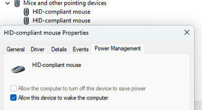

Bring up the mouse properties and uncheck Allow this device to wake up the computer
-> device manager
Thanks for your valuable reply. I done as you suggested but it's not working. same issue persisting. I tested by removing usb dongle of mouse from the board still mouse remained on. tested in different desktop but same issue. please help.
