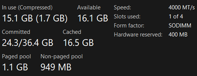

It seems that my laptop is not using the available full RAM speed of 5600MHz (MT/s), despite both the CPU and 5600MHz RAM designed to do so. I am unable to find anywhere in the BIOS to unlock the extra speed.

You can see below that the stock RAM, Hynix hmcg88agbsa092n , isn't performing as well as it should.

I am speculating, but from what I understand from the service manual it can reach that speed when it works in double channel, that is to say it has to have 2 equal memories otherwise I think it should work at a lower speed. I am not 100% sure about this but this is what I understand from the manual.
Buy memory that is not XMP this does not work in HP notebooks at its frequency designed by the seller, they go to lower frequency.

I have just installed two 32GB Crucial  DDR5 5600 RAM sticks:
https://www.crucial.com/memory/ddr5/CT32G56C46S5?_gl=1*1qndva*_up*MQ..*_ga*NjY5NDc5NzM1LjE3MzU2MzI1M...
64GB does show up, however, still only 4000 MT/s is in use.
