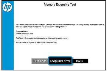

1NT85UA#ABAthis is the result I am gettingthis is the result I am getting
yes it does
OK that's windows version of battery calibration. If you are having calibration issues after that, then do the manual calibration when the whole test is done in UEFI BIOS, not in Windows.

  5. In the list of Component Tests, click Memory.
    calibration2.PNG.
  6. Click Loop until error to start the test. Let the test continue until the battery is completely discharged and the computer shuts down.
    NOTE:
    This test only discharges the battery and does not impact the memory.
