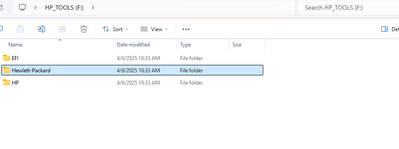

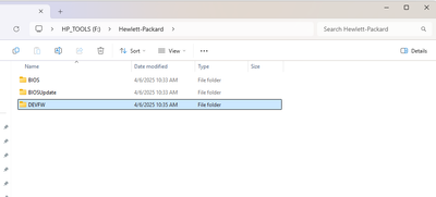

I created a recovery USB from the F.56 BIOS file at your laptop's support portal. Starting at the HP_Tools folder, I drilled down so you can see where the BIOS .bin file and its signature folder are. You can put those two files in their own USB flash drive and try updating from them.
