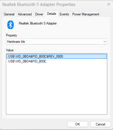

Type your Bluetooth driver hardware ID in the Microsoft Update Catalog search box.
If the list of drivers that comes out in the Microsoft Update Catalog does not match your OS version, try using third-party software such as Driver Easy Pro or CCleaner Professional Edition.
I'm sure you already know how to find out the hardware ID.
