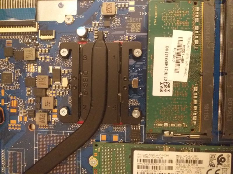

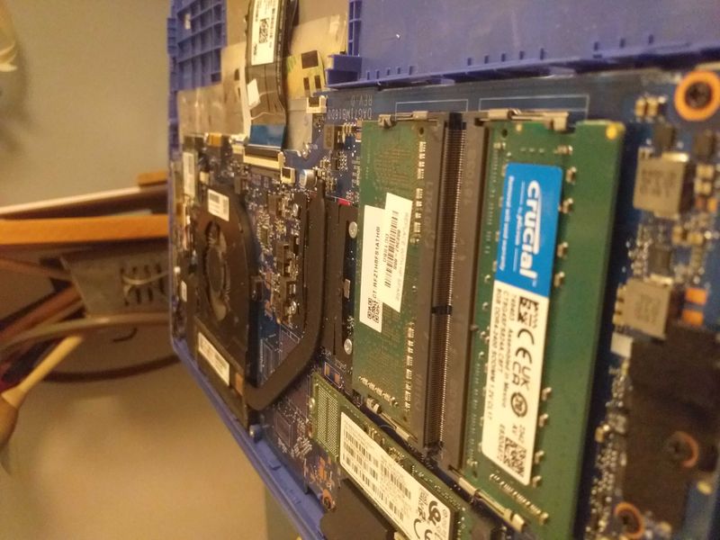

some photos, of inside of my HP laptop.
as you can see, there is no clear sign on where the CMOS battery is.... is was expecting to see a little round CR2032 battery i could change (as is indicated in the manual for my laptop series).. but it's not there.
so, i have the battery, just not sure where or how to find it and replace.
any advice appreciated.

Quite a few years ago, HP and other manufacturers started using current from the main battery to power the BIOS non-volatile ram chip.
There is no RTC, or button battery in your laptop for the BIOS.
ok. thanks for the clarity with this erico.. was surprised to not see a little disc battery when opened it up yesterday, but makes sense now... so u expect the manual i have could be updated it seems..
so, if i'm currently not using a mains battery (due to not having ordered yet, after realising how dead/expanded/about to explode it was... ), how will my BIOS get its power? can it still get it from the mains power cable, which is powering my laptop?
and possibly when i change/get new battery, it will resolve the error msg i get when boot up my laptop, saying 'CMOS error or something'? i assume so.
doesn't seem to be an issue so far, using without battery.. i wonder if it's ok for week or two or more?
