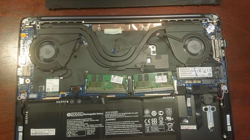

I hope some can help me with the following.
Is it possible to add a second SSD to a HP ZBook Studio G3, and if yes which type of SSD?
I noticed, when replacing/upgrading so-dimm memory, that there is a relatively large
empty space below the existing SSD (see picture, right side under)
zbook studio G3 open
Many thanks in advance
Peter
Hi,
It actually has 2 (two) M.2 slots and you can add a second SSD any time as mentioned on the following specs:
     http://www8.hp.com/h20195/v2/getpdf.aspx/c04832209.pdf?ver=3
Please use the following manual which shows you how to add the second SSD
     http://h10032.www1.hp.com/ctg/Manual/c04925075.pdf
Regards.
BH

thanks for the very fast and helpful answer!
best, peter
