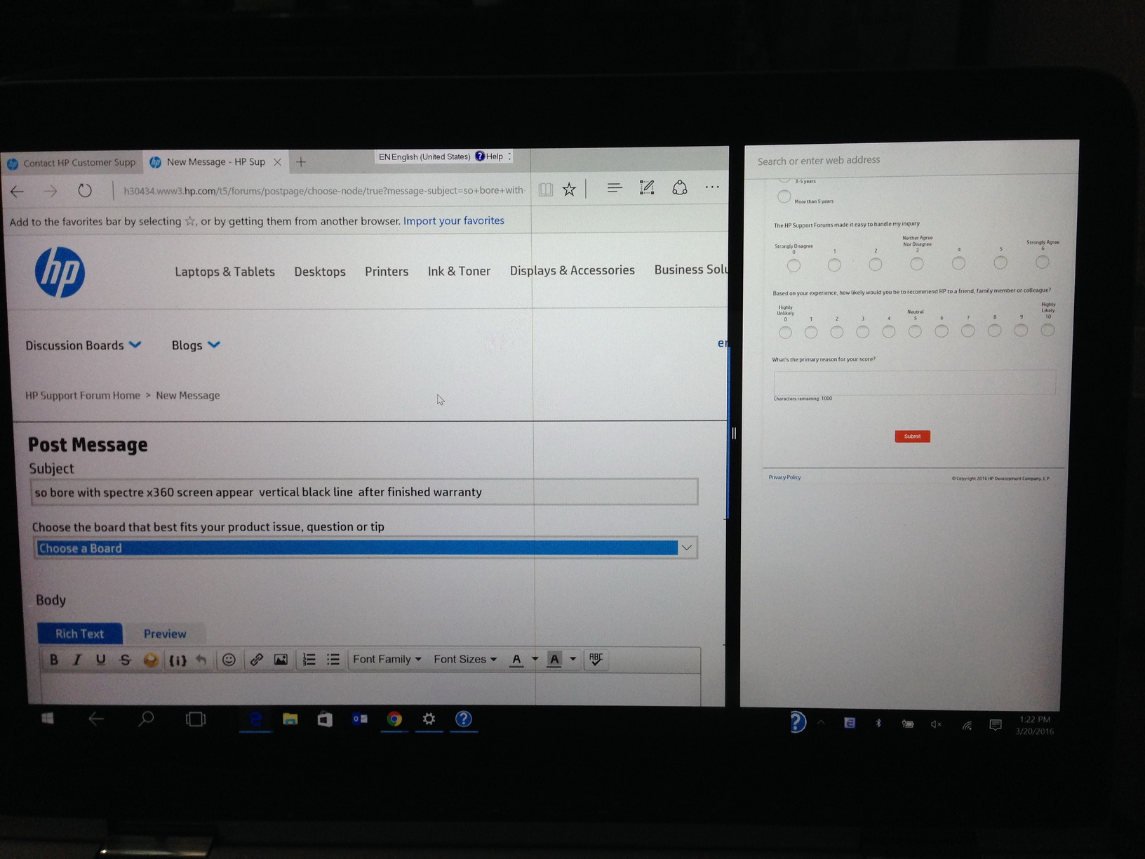

my Spectre x360 finished warranty the screen apear a vertical black line as attached picture, how can I repari it. It is sobore for the lap top qualityscreenerror.jpg

Hi,
I cannot see any vertical black line in the picture you attached.
Nevertheless, do a hard reset:
http://support.hp.com/us-en/document/c01684768
See if it is resolved.
Connect the laptop to another external monitor and see if black line is persisting there too.
Are you seeing this line when you're in BIOS setup after disconnecting from external monitor?
http://support.hp.com/us-en/document/c00034791
If yes, then it is most often hardware issue -display connectors going in to the board or display itself involved, and you need to get it repaired from HP authorised service centre (may be costly as you're out of warranty, and they may ask you change while display itself most probably) or good local computer repair center.

I check start bios also appeared vertical black line  Please HP consider quality of Screen for these model.
Hi,
Yes that indicate it is a hardware issue.

I changed attached picture without my laptop ID
Dear all volunteer supporter, thank you very much for your advice user of HP products,
My display case is very difficult to find repairer in Vietnam.
I describe more status of display. One day I opened my laptop the black line disappear for about 1 minute then appear again.
So I would like specialist of HP find out this damaged be long to cable to connect to display panel or display panel damaged its own.
