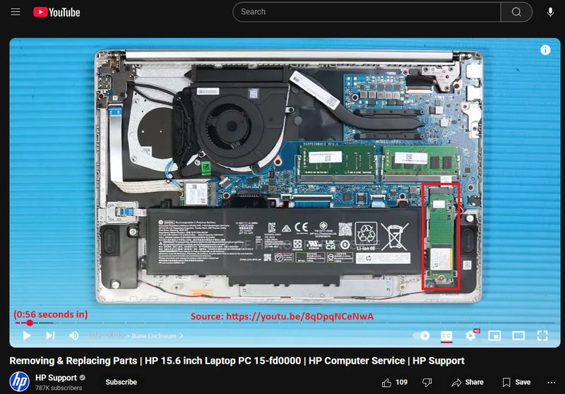

Take a look at the video HERE  from HP on your laptop, on how to get inside. The picture below shows what is on the right side rear face... viewed from the rear. The hinge edge is up in that picture, for perspective.
Outlined in red is the internal NVMe M.2 form factor SSD. These can get hot. Memory is above on that same side, which also can get hot. HP does not show a heatsink over the SSD and likely are using the rear cover as a heatsink instead. Working from bed with your laptop resting atop a down comforter would not be a great idea here.
Viewed from rear, hinge at topViewed from rear, hinge at top
