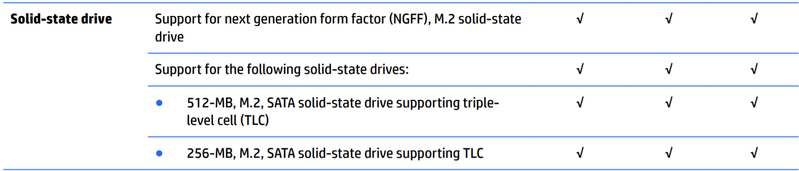

I checked again, it does say that m.2 SSD is supported for my model and all other models actually.  In the parts section it does talk about different MB's and some support HDD and some HDD AND SSD, but the first section "Product Description" tells what is supported, AND IT IS WRONG!

I don't have a shop and really shouldn't have bought this ssd, but do have over 1100 customers that I influence directly.  Unfortunately I will be holding on to this ssd for way too long when I could have just got an 2.5" model instead.   This pic shows all three across are checked, which means all laptops in this range are supported, pg-10.  If this were a one time thing I can understand, but this is ongoing misinformation that is costing me time and money.  I think HP should send me a motherboard that supports m.2 now haha.  Or just send me a nice business class laptop please haha.
