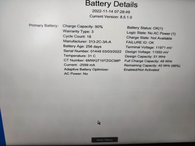

How much battery capacity is remaining as compared to the factory battery design capacity?
YOu will see both of those when you p[erform the battery test in the result.
What it means is that the 100% Factory design capacity is not going to be the same as the current fully charged 100%.
The 100%  full charge percent metric changes over time as the Lithium battery cycle number increases.
Your notebok is not really meant to be playing games like GTA on it without being connected to the power adapter.
That is why after a couple of hours of playing a graphics intensive game in performance mode on battery, it shuts off when the charge gets down to the minimum amunt that is set in Windows power options.
As far as battery life goes, if you want to have a long battery service life, leave it as is.
If you wanrt to play a game for a long time, say more than an hour or so in competition,  use the power adapter.
I understood what you said last time, thanks for that and these were my results after checking it
so till how much should I charge my battery it says 90% ?

HP recommends leaving that set to 80%, but since I can replace the battery myself I just have it set to 100%. I  usually get about 2.5 years out of a battery.
If you set the Battery care setting to 90% you will get more time to use the laptop on battery, but it will reduce the battery service life.
Setting the Battery Care setting to 90% means that you will have 90% of 46wh (laptop on battery time) when the laptop is fully charged.
It is a bit of a trade off.
