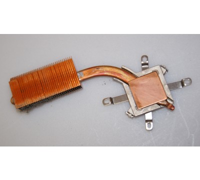

> after about 30 sec CPU was becoming hot after about 60 sec it became almost to hot to touch.
I want to be very clear about this.
Are you really touching the CPU itself, or are you touching the copper "heat-pipe" that should be sitting on top of the heat-paste, which itself is on top of the CPU?
The copper should be conducting the heat to the "radiator", and the fan should be moving air through the radiator, and the warm air out through the exhaust vent.  So, it is "reasonable" that the "rectangle" (see the picture) itself will be hot, as the heat is being transferred to the radiator.
[Sometimes, it takes a while for a "moderator" to "approve" that the picture be visible.]
