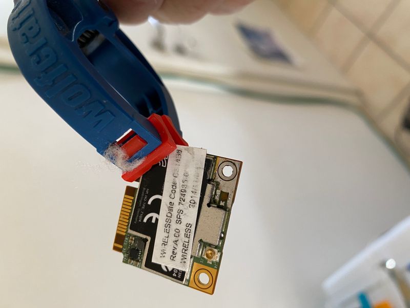

 but that is as difficult to modify this antenna from ebay to look like this mine above as to solder one receptacle and one plug which cost only some 10$. Receptacle connector onto the wlan module and plug connector onto the antenna...
 I want to try this soldering as my wifi needs only these 2 connectors well soldered to work...will send you news about this discussion.
johp13
Hey Hi
I have just ordered the antennae you sent me the link! Why? Because as you can see the photo here :
I have tried to solder a new connector but I damaged the pcb...or could it be repaired?
And I didn't find the right connector for repairing my damaged antenna main.
So it is and I  ordered a new module wlan too , not cheap...
All in all im a little confused about all that but I want to finish this work.
I will probably contact you when the two things are in my possession, because im not sure with the antennae are they long enough or will I have to do with them.
I saw a post in which you assure that the top part of them can cut and wrapped in electrical tape. Are you sure of that?
johp13
Yes I have done it and reception was still fine. Still, not optimum. On a 17 inch you can mount the top pieces along the side of the screen if the leads are not quite long enough to reach the top.
