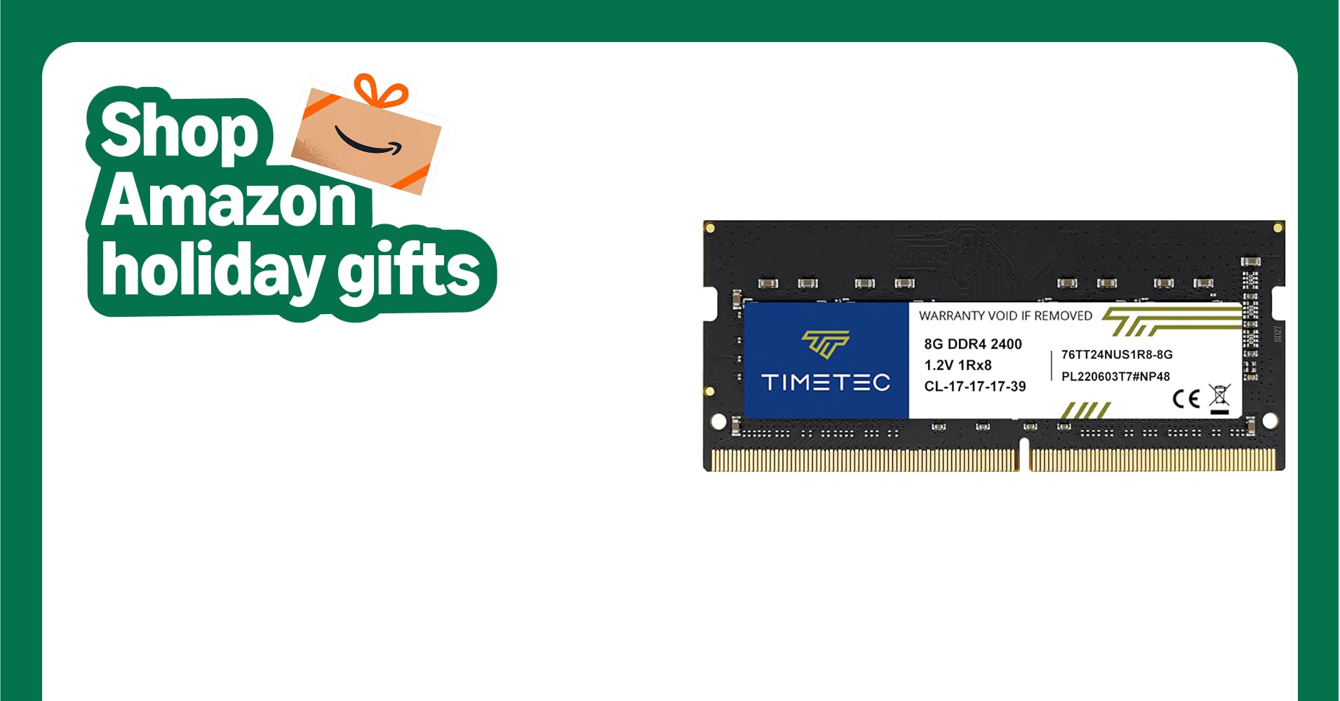

You have the A6 processor so a single memory slot now filled by a 4 gig module. You can upgrade to a single 8 gig DDR4-2400 SO-DIMM which will downclock to run at -1866 speed. DDR4-2666 or -3200 would work OK, too. See p. 43 of the Manual for "how to".
Don't know about how you did it before but I have done many dozen laptop memory upgrades without issue as long as you get compatible memory. You don't tell us what you found online. You need, as I said DDR4-2400 SO-DIMM and it should be stock OEM stuff like Hynix Samsung, stock Crucial. As so:
Timetec is made by Hynix specifically for Amazon sale. Very good stock OEM memory will work fine for you. The 4 gig to 8 bump should be noticeable but don't expect miracles.
