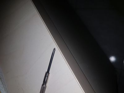

Good day today I disassembled my notebook to be able to put a Samsung SSD to make it much faster but I can't disassemble the hardisk from the metal part that holds it close to the SATA connector, in fact I tried with several screwdrivers but I can't take out the screws could you give me an amazon link with a suitable screwdriver? I am attaching the photo of the screw and the screwdrivers used

Sorry to say but those bulk "jewelers" screwdrivers are typically junk and often too small. Your best option is to purchase a WERA or WHIA #1 and #2 phillips drivers. That is really the only sizes you will encounter. STOP using what you have before you strip the head and make your life even worse. TIP: if a screw feels very tight and refuses to come out, sometimes tightening it slightly will "break" the threads free.

These are the ones I took that is, they recommended ph 1 and 2, I wait for them to arrive
Link https://www.amazon.it/gp/product/B003ES5L86/?tag=tomsforum-21&linkCode=ogi
Link 2
https://www.amazon.it/gp/product/B000X1SZYY/?tag=tomsforum-21&linkCode=ogi
anyway, thank you for the advice, I expect it to arrive on Monday and I'll let you know if I have solved it.
