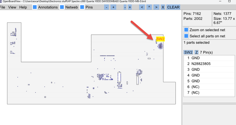

trying to find a source for a power button board for a HP Spectre x360 - 13-4195dx (ENERGY STAR)
That is the one electrical part that is not listed in the PartSurfer listing or in the Maintenance & Service guide.
Initially I considered that the switch might be part of the system board and that does appear to be the case.
If you have the notebook open, you will likely find a microswitch that is activated when the power button part of the notebook lower enclosure is slid toward the power on position.
I just verified that by looking at the boardview file on OpenBoardView. The power switch is SW2 and it is on the system board.

Thanks for your efforts. I was not aware of the open board listings.  Also the part listing I had did show a separate power-on board but I must have gone to the wrong product page.
Thanks for the help, now I just have to find the switch itself.
