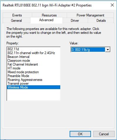

I have the 802.11b/g/n (1x1) adapter and on windows 10  in the adapter advanced properities there is no option to enable N, and the  wireless mode only gives values for b/g. How do I enable N, even with 1 x1 spacial channel? Drivers are all up to date and Connected to an N router.
Also, I am upgrading to an AC3100 router in the future,  Since N standard supports both 2..4 and 5 GHz bands, I sould not need a new adapter, with the single anntenna, correct? BTW there is currently Realtek RTL8188EE.JPGRealtek RTL8188EE.JPGno option for 802.11n channel bandwidth for 5GHZ, only 2.4
