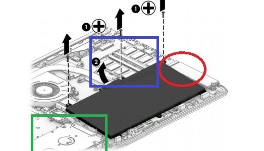

i am having hp 15-15da1005nv laptop with i5 8265, 4gb ram and nvidia mx110, win 10 64bit
i woould like to upgrade the memory but i want to know the slots of the memory that the laptop has
and until how many gb can i go?
the product id is 5xn51ea#ab7
and serial CND9083BNR
because i searched and haven't found a solution for sure
thk you in advance

2 memory slots; one is used now. Start on p. 37 of the Manual for "how to". Once the back cover is off you see this:
memory slots in purple squarememory slots in purple square
Uses DDR4-2400 SO-DIMM. The Manual says up to 2 x 8 = 16 but you can safely go to 2 x 16 = 32 gigs.
