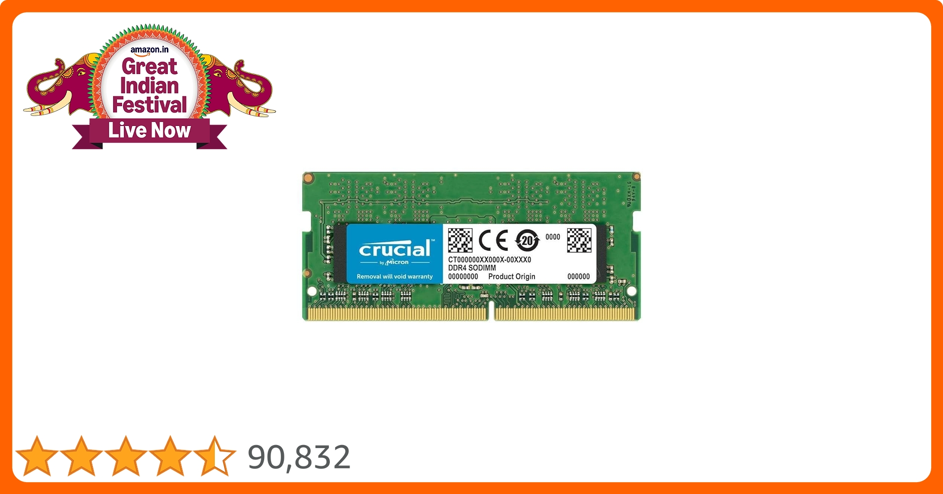

10-27-2023 06:55 AM - edited 10-27-2023 06:57 AM
Hi, @TzortzisG
The problem is that Crucial DDR4-2400 memory is very expensive in India for some reason.
16 GB DDR4-2400:
The 16 GB DDR4-3200 is out of stock right now, but if memory serves me right, it was somewhere in the ballpark of 2,800 Rs.
That is why most folks buy the DDR4-3200 memory which used to work just fine.
I certainly would have bought the faster DDR4-3200 memory if it was less than half the price.
I even believe that HP fitted most of those 15-ec0xxx notebooks with DDR4-2666 MHz memory and it bridged to 2400 MHz.
It primarily depended on what memory they had on hand at the assembly plant at the time.
