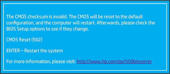

Also, I suggest you perform a CMOS reset.
Reset the CMOS on consumer notebooks
To perform the CMOS reset with the key-press combination, perform the following steps.
Plug in the AC adapter.
Turn off the computer and wait for at least five seconds.
Press and hold the Windows key + v key-press combination.
While pressing the keys, press and hold the power button for at least two seconds but no more than three seconds.
Release the power button, but do not release the Windows key + v key-press combination until the CMOS Reset screen is displayed and/or you hear beeping sounds.
At the completion of a successful CMOS reset, a message similar to the following is displayed. This is confirmation that the CMOS values have been reset. The unit restarts, and then you can access the BIOS and UEFI Diagnostics.
Confirmation message stating CMOS values have been reset.
Reference: HP PCs - Reset the CMOS | HP® Support
I hope this helps.
Please feel free to reply here if you have any questions or if you need further clarification on any of the steps.
