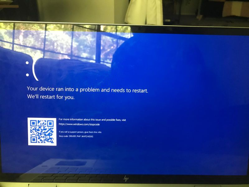

Getting Blue Screen Error with Stop Code - Driver PNP Watchdog. I tried booting the laptop using Windows Recovery using flash drive but Hard Disk was not detected to Repair or Reinstall Windows.

Earlier I was doubting corrupt Hard Drive but after performing Diagnostics it says OK.
The test result indicates that the Hard Drive/SSD test - 1st Pass has been successfully completed. The following checks passed:
- Hard Drive/SSD SMART Check
- SSD Wear Check (wear level is 8%)
- Hard Drive/SSD Short DST Check
- Hard Drive/SSD Quick Test (1 of 2)
The PASS ID is 24847-44210-69654, and the serial number is Edited. No issues were identified with the hard drive/SSD. You can save the results in the Test Logs via the Main Menu and consider running advanced tests for expanded coverage by selecting the Continue button.

Based on your description, you're encountering a Blue Screen Error with the Stop Code: DRIVER PNP WATCHDOG on your HP ENVY x360 15 series laptop, and Windows Recovery doesn't detect the hard drive, despite diagnostics showing the SSD is healthy.
This issue typically relates to driver or storage controller problems, especially during boot or OS installation. Here's a step-by-step guide to help resolve it:
