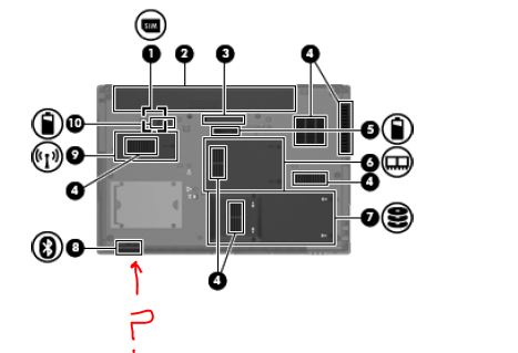

is it plugged in , inside the LP bottom, see drawing below.

hatch 8, and pcb inside, must be plugged in.
