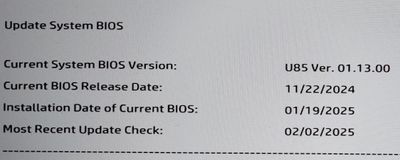

there was a new bios update but so far it hasn't fixed the problem. Did you disable the settings on the BIOS? if not you can try what was listed above and roll back the wifi driver to an older version. I have done it on a couple laptops and so far they havent blue screened

Hello, I haven't had any problems since I reinstalled my laptop.
Also, I disabled an option in the DMA protection's properties.
I will attach photos to show you:
