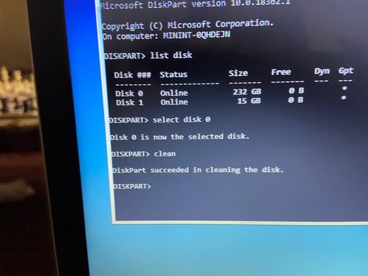

Hi,
I ran diskpart.
I also ran diagnostics test on SSD disk, and it passed.
I compared checksum of ISO image files with files on USB drive, all checksum matched.
When I finally get to install, I get this error now 😞
Any help here?
