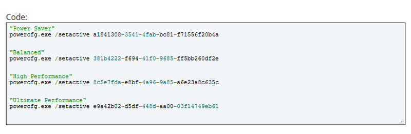

Hello again - upon Google invesitgation, the command prompts you recommended are to restore the following power plansCapture.PNG
However, I am not trying to restore the plans (e.g. I already have 'Balanced') but am merely trying to restore the advanced settings that are not configurable as they don't exist. Even if I create a custom plan.
If i were to restore all of the above, then how does this work and does it conflict with the battery slider? I understand that this was the whole reason the power saver, high performance etc. options were removed a few years back, becauase there was no need for them due to the battery slider being introduced and thus only requiring a default 'balanced' plan which in essence can be power save or high performance by changining the slider to 'best battery' and 'best performance' respectively

Just to confirm and so that other users are aware, I used the command prompt tool and entered
powercfg -duplicatescheme 381b4222-f694-41f0-9685-ff5bb260df2e
This has no positive effect. All it did was duplicate the 'balanced' power plan that I already had, but the advanced power options were still not complete. In the end I just deleted the additional power plan that had been created from the command prompt as it had no postive impact. I'm still missing the option to adjust USB settings, processor power management etc.
Thank you for your help, but will log with HP Support
