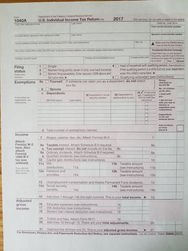

Printer started to print erratically.  Some Word documents do not print at all.  Some word docs prints 3 or 4 lines, skips 2 or 3 lines, prints 2 or 3 lines.  PDF documents print the full page but parts of the document info is missing.  I am able to print scanned documents (PDF format).  Is printing blank PDF forms but once they are filled out it prints with sections missing (see photos attached).  I have uninstalled & reinstalled the printer, downloaded the latest driver, done a power reset and printed several test pages (see copies attached).  Any ideas on what to try next?
Blank 1040ABlank 1040AFilled out  104A form with many  sections missingExtended Self Test Diagnostic Page 1 of 2Extended Self Test Diagnostic Page 1 of 2Extended Self Test Diagnostic Page  2 of 2Extended Self Test Diagnostic Page 2 of 2HP Print and Scan Doctor 5.1 Test PageHP Print and Scan Doctor 5.1 Test PageWireless Test PageWireless Test Page

I followed your instructions and try to align the printer.  It came up with an error:
FAILURE
Print cartridge alignment failed.  See the product documentation for details.
This is what it printed:
Alignment pageAlignment page
As you can see,  the top part of the printed page is blank so I can't read the product documentation details.
Printer is working the same.
